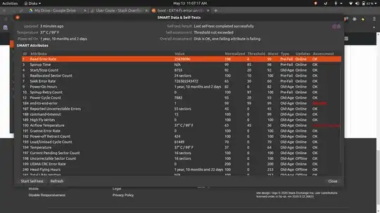

Edit: As requested, below is a screenshot of my Disks pageDisks

Lets check your file system for errors.
For 18.04 or newer...
  • boot to a Ubuntu Live DVD/USB in “Try Ubuntu” mode
  • open a terminal window by pressing Ctrl+Alt+T
  • type sudo fdisk -l
  • identify the /dev/sdXX device name for your "Linux Filesystem"
  • type sudo fsck -f /dev/sdXX, replacing sdXX with the number you found earlier
    • sudo fsck -f /dev/sda7
  • repeat the fsck command if there were errors
  • type reboot
Note: If you continue to have problems, we'll bad block your disk, using procedures that I can add later.
Update #1
Note: do NOT abort a bad block scan!
Note: do NOT bad block a SSD
Note: backup your important files FIRST!
Note: this will take many hours
Note: you may have a pending HDD failure
Boot to a Ubuntu Live DVD/USB in “Try Ubuntu” mode.
In terminal...
sudo fdisk -l # identify all "Linux Filesystem" partitions
sudo e2fsck -fcky /dev/sdXX # read-only test
or
sudo e2fsck -fccky /dev/sdXX # non-destructive read/write test (recommended)
The -k is important, because it saves the previous bad block table, and adds any new bad blocks to that table. Without -k, you loose all of the prior bad block information.
