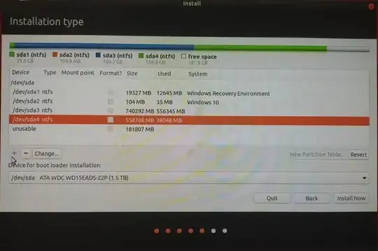

I have tried to shrink my drives using dskmgmt.msc, but it only shrunk them by a few GB's. When I try to install Ubuntu, I have no "Alongside the current installed OS" option. I tried the Something else option, but I was given no choice to create the swap and root partitions. I'm not even sure which is the D:\ drive.
Here are the partitions -
partitions
Could I remove my C:\ drive and just deal with that later and install to D:\?
Edit1; I have removed the partition for the D:\ drive (I believe it's /dev/sda4?) and it appeared as 'free space'. I created a swap area following the instructions here, but I couldn't continue to the next step as I no longer have free space to create a partition for root. I read somewhere there can only be a maximum of 4 partitions.
I no longer have Windows 10 installed on my system. Can I remove /dev/sda2? I don't understand why it doesn't show Windows 7.

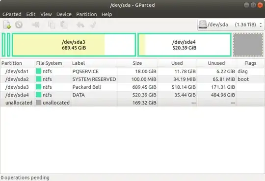

Edit2: Added screenshot of GParted. I can shrink Packard Bell by about 175GB. Is that enough for Ubuntu? I assume I could still use D:\ with Ubuntu. Maybe it would need to be formatted to a different file system?

As far as your question goes "Can I install Ubuntu on second hard drive D?" the answer is simply YES.

As I saw you had issues recognizing your D drive. To ease the process you could first delete your D drive from Windows and then when you access it from Ubuntu installation it will be displayed as freespace. ( You can use this article to know how to delete a partition ).
You might see other partition apart from free space those partitions are used by Windows, it better not to concern yourself with those partitions and make new partitions from free space for your Ubuntu. Ubuntu does not use alphabets to identify a partition like Windows instead it use /dev/sdxx ( to learn more about them you could use this ).
Linux file system is different from Windows, you need to make a partition with mount point set as / to install OS to that partition, you could also make another partition your home directory by specifying /home as mount point for that partition. This helps if you wish to change the linux in future as your files will be on separate partition.
