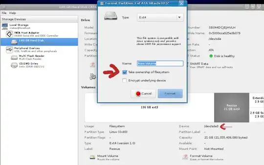

1- First I made the partition to store the .iso files I settled on 20Gb, resized my orginal partition, and made a new one using gnome-disk-utility Install gnome-disk-utility, Then formated it with the ultity with the check box "Take ownership of filesystem" this solves problems with puting files on the drive, because gparted made the partition owned by root. enter image description here
Also make note of the device name for that partition, you need it to tell grub where the partition is.

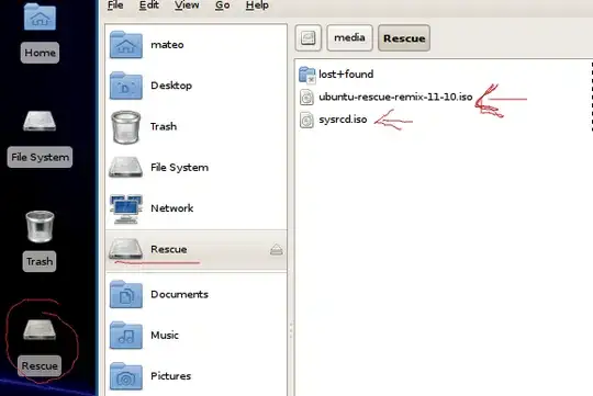

2- Next I placed .iso files into the drive that now should be on the desktop to be mounted, enter image description here
