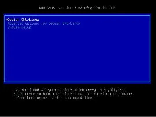

  3. Replace the 32 bit Debian with a 64 bit Ubuntu. Start by booting to Grub. If the Mac does not boot to Grub by default, then restart the Mac and immediately hold option key until the Startup Manager icons appear. Select the internal drive icon labeled Windows. When an image similar to the one shown below appears, press the C key.
    GNU GRUB
    Enter the commands given below to boot from the /dev/sda3 partition. This sequence of commands was derived the question Using a bootable live cd disk image mounted on the hard drive.

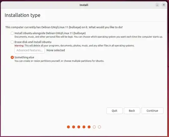

    Proceed with the installation of Ubuntu. When an image similar to the one shown below appears, select Something else, then Continue.

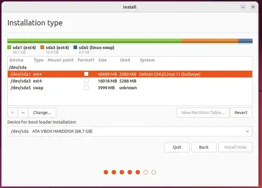

    When an image similar to the one shown below appears, select the line containing /dev/sda1, then Change….

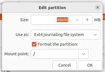

    Except for the Size, configure the partition setting as shown below. Do not change the size. When finished, select OK.

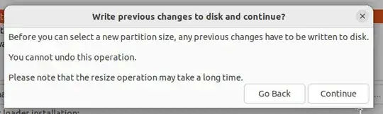

    Even though the size was not changed, the following popup may appear. If so, select Continue.

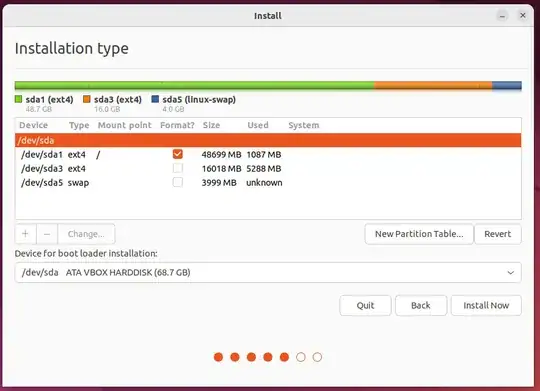

    For this example, the result is shown below. Select Install Now.

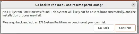

    Even though no EFI System Partition is needed, the following popup may appear. If so, select Continue.
    Continue and finish installing Ubuntu.
