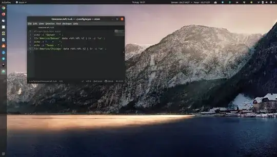

Example image:
Where multiple clocks from different time zones are displayed adjacent to the clock that is normally there in the top bar of Ubuntu 19.

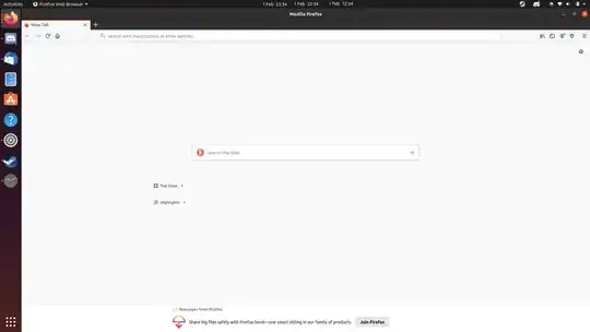

Here's what mine looks like:
