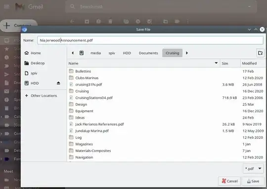

The issue I have (and I spent many hours looking for an answer) is that when I save anything from Chromium, it saves using a "Save File" window that forces me to double click, shows files and folders in mixed up in alphabetical order and no favourites. enter image description here
I have no idea as to what File Manager Chromium insists on using and I would like to force it to use Dolphin.

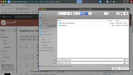

Install plasma-browser-integration
sudo apt install plasma-browser-integration
Then install the plasma integration extension, and restart Chromium.
Image: Qt file manager widget in action in Kubuntu 20.04, with all bookmarked folders.
I have verified that this answer works for apt version of chromium and also firefox (the same plasma-browser-integration package and the same Plasma Integration add on). OP reported that it does not work with the snap version of Chromium, which Ubuntu ships. One can either can install chromium without snap instead, or open a bug at Launchpad to let the Ubuntu's chromium packaging team know about this.
