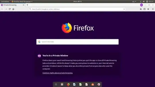

If you want to see the dock at all times.. here is the workaround..
Don't turnoff the Auto-hide feature as you mentioned in the Question.

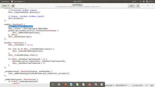

locate the dash-to-dock extension direcotry, it could be either in $HOME/.local/share/gnome-shell/extensions/ or /usr/share/gnome-shell/extensions/
open the file intellihide.js, in my case it is
$HOME/.local/share/gnome-shell/extensions/dash-to-dock@micxgx.gmail.com/intellihide.js
at line number 105 (this._isEnabled = true;) # Change the value to false
enable: function() {
    this._isEnabled = false;
    this._status = OverlapStatus.UNDEFINED;
    global.get_window_actors().forEach(function(wa) {
        this._addWindowSignals(wa);
    }, this);
    this._doCheckOverlap();
save the file & close.

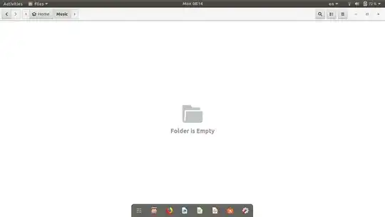

refresh the gnome-shell with Alt+F2 type r and press Enter

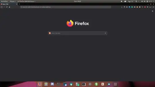

I am using Ubuntu 20.04.6 LTS.
PRATAP's solution didn't work for me initially, but the problem was that I hadn't remove Dash to Panel gnome shell extension.
You can simply remove an extension via the website:
https://extensions.gnome.org/local/
Just click the red X button to uninstall the extension instead of trying it on CLI.
After removing the panel, it works like this.
