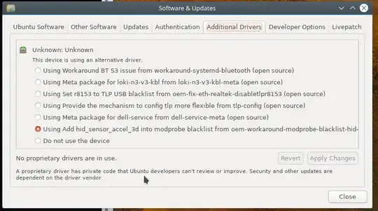

Under software and updates I have one unknown.unknown driver, could this be the problem?
Screenshot of my additional drivers tab
If this is Ubuntu only issue, will switching to some other distro help? I'm thinking Arch or openSUSE.

I generally recommend one to stay with LTS - do not upgrade to non-LTS version because if you want to keep getting updates, you will have to upgrade your non-LTS version again (and again), and those non-LTS upgrades are very fragile and unreliable. In comparison, upgrading from LTS to LTS is much more robust.
Keep your LTS, if you need newer kernels, install the hwe stack, see instructions from here
https://wiki.ubuntu.com/Kernel/LTSEnablementStack#Ubuntu_18.04_LTS_-_Bionic_Beaver
FangQ
  • 387
Unfortunately, everything I've tried didn't work... I ended up switching to openSUSE, it works without any problems, no more freezing.
