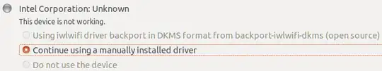

  2. In the software update settings this is what looks like: software update settings
I've been searching for more than 2 hours and applying all possible solutions I found, but none of them fixed my problem, so I reinstalled Ubuntu 18.04.3 from scratch.
