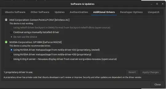

Something strange I noticed; apparently the WiFi/Bluetooth is not being even used? (Though WiFi works flawlessly), see below screenshot :
(Link to screenshot)

Regarding proprietary drivers for this chip. It is not required if the chip is supported by in-tree kernel module.
