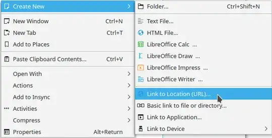

  • Navigate Dolphin to ~/Desktop.
  • Right-click → "Create New" → "Link to Location (URL)..."
    Right-click menu

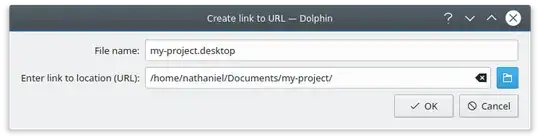

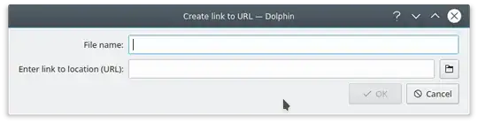

  • In the "File name" field, enter "my-project.desktop"
    Dolphin - Create link to URL
  • In the "Enter link to location (URL)" field, click the folder icon ("Open file dialog") and navigate to ~/Documents/my-project, then click "Open".
    Fields filled in.
  • Click "OK".

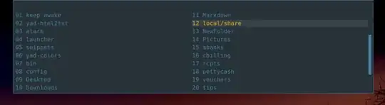

Another way is to use Rofi. In the image below, I typed 12. Pressing Enter now would open ~/.local/share in Dolphin. Similarly, I could open ~/bin, ~/.config, ~/Downloads, etc. The same screen also lets me launch certain scripts (that don't need to be run from a terminal), and to open documents.
Using Rofi to open folders
