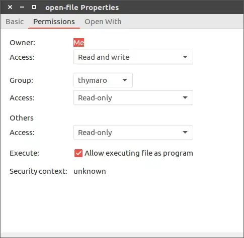

### EDIT 3
From this question, I deduct that I have done everything right and the file should be clickable and be executed upon clicking. Unfortunately, it doesn't. I think my permissions are correct, afaik
and same here
-rwxr-xr-x me me 94 Apr 27 12:00 open-file
