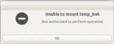

I'm using Ubuntu 18.04 with nemo as the file manager, and out of nowhere I can no longer mount disks or partitions which show up just by double-clicking them, when just a few weeks ago this worked perfectly fine! Any idea what changed? Perhaps an update messed it up?
The error is:
Unable to mount NAME_OF_DISK. Not authorized to perform operation.
Screenshot from nemo file manager:
