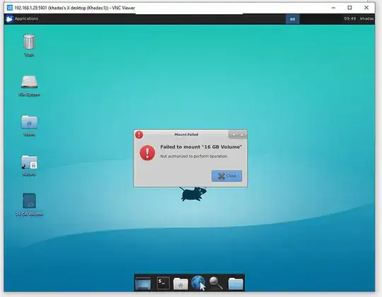

I'm using an SBC (Khadas VIM1) with Ubuntu 18.04.6. I have an SD card formatted in FAT32 on it and I'm having access to Ubuntu via the VNC server.
On the desktop, I clearly see that the SD card is correctly showing but when I try to mount it pops up the error Failed to mount Volume. Not Authorized to perform operation
I've read multiple questions about this issue like this and this and this
The thing is that's no chrome remote desktop installed if I run sudo apt autoremove chrome-remote-desktop it says there no chrome-remote-desktop installed
If I manually mount it via terminal with sudo mount /dev/mmcblk1 /mnt/sdcard everything works fine.
Could it be because the VNC server is running (that's strange to me as, even with the server running, I'm able to mount the sd-card via terminal)
