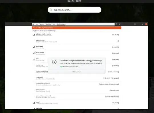

Invoking dconf-editor causes it to be mapped underneath (in z-order terms) the Top Bar window, leading to a bad situation like this whereby I cannot even close the window because the enter image description here icon is obscured to the point where I cannot even click on it using the mouse:
dconf-editor

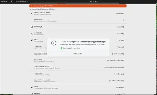

I tried to manually close this window by using the Windows key to get to the enter image description here icon, but it shows that the icon is not there for the dconf-editor in that view either (why? it is for my other top-level application windows, so what makes this one so special?), so I cannot even close it:
dconf-editor after Windows button

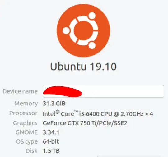

I'm using Ubuntu 19.10 running Gnome 3.34.1 (whatever Ubuntu uses by default):
About Ubuntu
