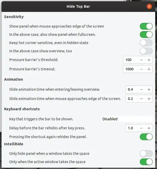

I followed the instructions in https://askubuntu.com/a/1029905/340383 using this configuration:
Hide Top Bar settings
Which seems to be correct, but the Top Bar is still showing on the right monitor (I have a left and right monitor):

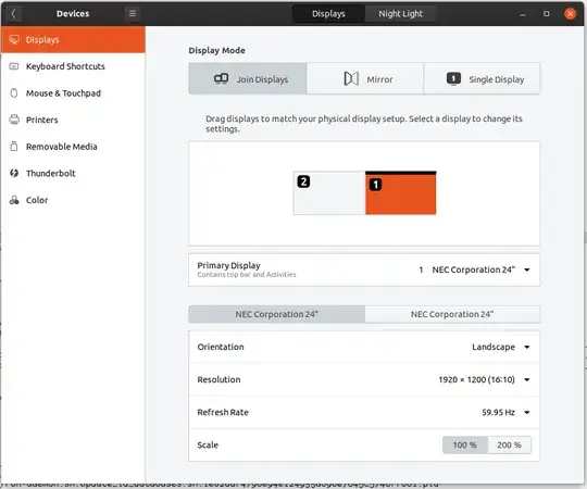

Here is a screenshot of the Settings/Devices/Displays window showing two NEC 24" monitors. The Top Bar is showing only on the right monitor (the one identified as "1", likely because I used the drag/drop inside that window to move "1" to the right, but not sure that is the root cause of this problem). enter image description here

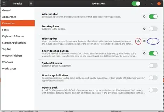

In response to @vanadium's comment, I opened up Gnome Tweaks, and started to do that test, but then got distracted by the icon highlighted with the red ellipse below, and then to the right of it saw that the Hide top bar extension seemed to be disabled.
Hovering the mouse over the icon in the red ellipse just shows "Error loading extension", which is pretty vague.

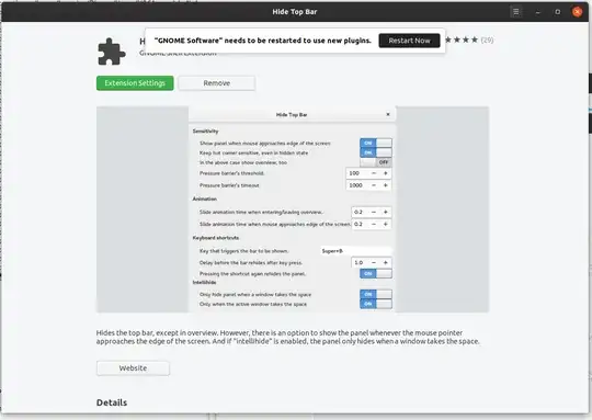

Clicking on one or two of the items inside the Gnome-Tweaks/Extensions view shown above popped up a note about needing to restart Gnome. Why didn't it prompt me for that somewhere when I installed the extension? Or did it and I just didn't see it?:
Gnome Tweaks click Extension showing restart message

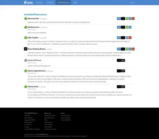

Prior to uninstalling anything as suggested by vanadiums answer, here is a FireFox page screenshot of what I see from https://extensions.gnome.org/local/
This seems to correlate with this command-line result:
$ cd /usr/share/gnome-shell/extensions/
$ ls -1
desktop-icons@csoriano
system76-power@system76.com
ubuntu-appindicators@ubuntu.com
ubuntu-dock@ubuntu.com
$ cd ~/.local/share/gnome-shell/extensions/
$ ls -1
alternate-tab@gnome-shell-extensions.gcampax.github.com
hidetopbar@mathieu.bidon.ca
show-desktop-button@amivaleo
I suspect the ones under ~/.local/share/gnome-shell/extensions/ came about via the GNOME Shell integration Firefox extension
