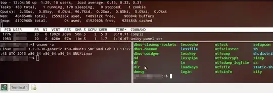

Alternatively there is a new experimental project called Terra.
Terra is a GTK+3.0 based terminal emulator with useful user interface, it also supports multiple terminals with splitting screen horizontally or vertically.
Terra Terminal Emulator Screenshot

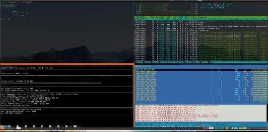

Alacritty/Guake + Byobu
I use (now on 20.04) Alacritty (before I used Guake, any modern virtual terminal will be fine; could be just GNOME Terminal) with Byobu as shell interpreter, which by default use tmux as backend (probably better than screen).
Three steps
  1. Install: sudo apt install byobu (no PPAs needed).
  2. Add it to available shells: which byobu | tee -a /etc/shells, as I told in this Guake Github issue.
  3. On Guake preferences (guake-prefs) choose Byobu as the default interpreter: image
  4. Optional: Hide tab bar, since you will use Byobu for that:
  5. If a shortcut doesn't work, try disabling Guake ones that might interfere (in my case was Ctrl+F2 for vertical split): screenshot
