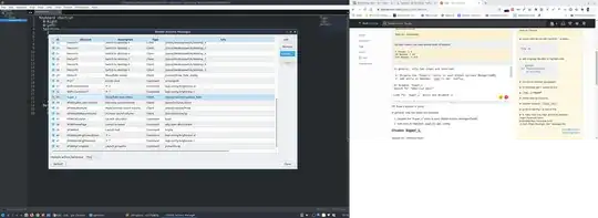

  1. Disable the "Super_L" entry in your Global Actions Manager(GAM).
  2. Add entry in Openbox lxqt-rc.xml config.
Disable Super_L.
Search for "Shortcut Keys".
Look for Super_L entry and disable it enter image description here
Configure Openbox keyboard binding.
Nice keyboard binding entry is found here in openbox documentation, they call it as "Window Snapping":
