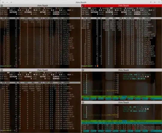

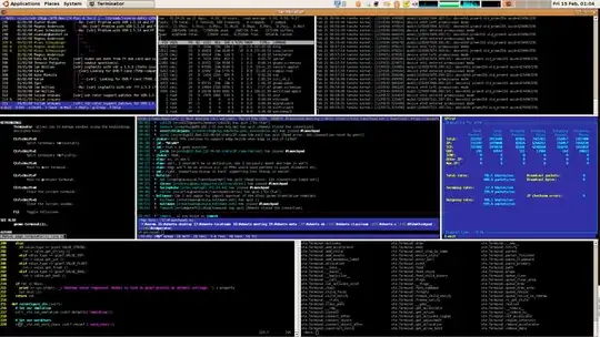

I also use/d iTerm2. After trying out tmux and Yakuake, I opted for Terminator and am very happy with it. Reason being, I didn't want a purely CLI-based multiplexer (tmux) ... I wanted more GUI based controls. And I didn't want a KDE based GUI (Yakuake). Terminator was the closest I found to iTerm2. The only feature I didn't find was the "clear" feature.
After deciding to switch and coming to post this answer, I noticed @jrg said this also, as a comment. I posted this because I almost missed Terminator and don't want others to miss it.
I became totally dependent on split-screens, and now my addiction can rage on:
Simple layout example. horizontal and vertical splits screens
Complex layout example. very complex layout
To install on Ubuntu or Mint, search for Terminator in Software Center ( Software Manager on Mint )... or open Terminal and type:
sudo apt-get install terminator

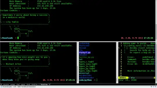

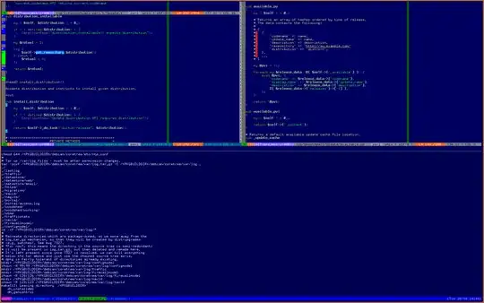

Even on the mac, I am using tmux! :)
split
(source: github.io)
To install:
apt-get install tmux
