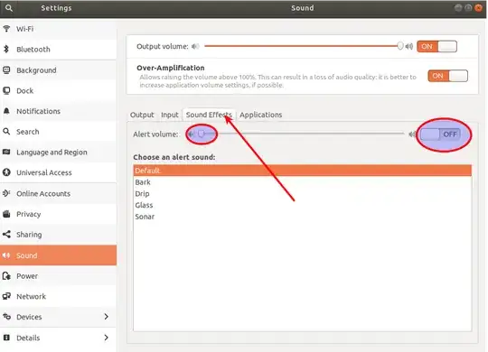

Go to Settings → Sound → select Sound Effects tab
Choose Alert Volume and set to OFF (or at least reduce the volume)
