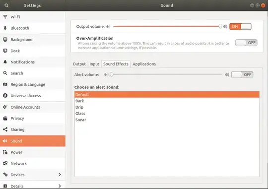

In order to turn off Ubuntu error sound in Ubuntu 18.04 you need to go Setting > Sound > Sound Effects > Alert Volume > Off.
Sound settings dialogue

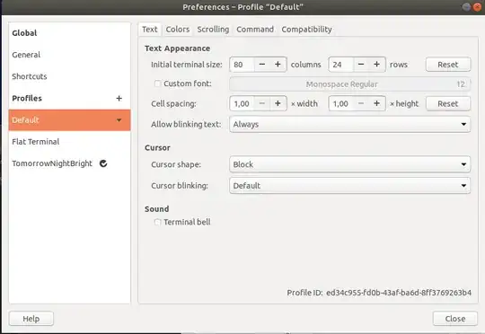

If you just want to turn off on terminal in Ubuntu 18.04, open Terminal > Edit > Preference then choose your terminal profile and uncheck Terminal Bell

For turn off terminal sound you need go to terminal, then go to tab edit > preferences and uncheck terminal bell.
