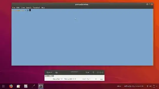

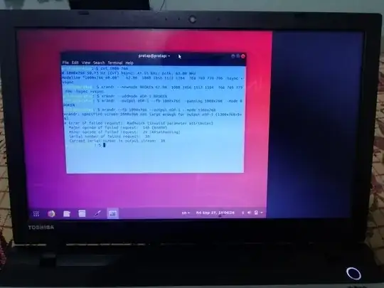

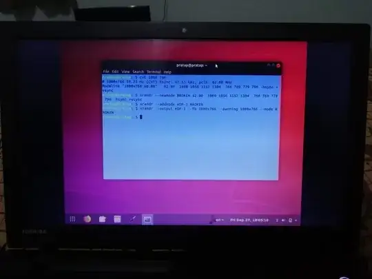

you can achieve this with xrandr with the help of --fb --panning which you missed in your workout..
below are the working commands when I did it my system which are self explanatory..
my Original Screen Resolution is 1366x768 (eDP-1) and I tried to use 1000x768 leaving the blank space on Right
cvt 1000 766
xrandr --newmode BROKEN 62.00  1000 1056 1152 1304  766 769 779 796 -hsync +vsync
xrandr --addmode eDP-1 BROKEN
xrandr --output eDP-1 --fb 1000x766 --panning 1000x766 --mode BROKEN
xrandr --fb 1000x766 --output eDP-1 --mode 1366x768
