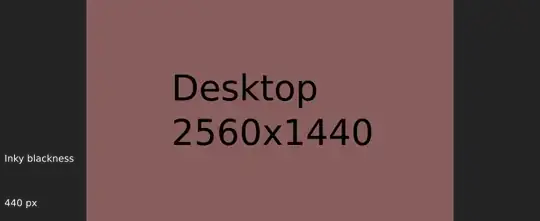

I would like to be able to use my ultrawide monitor as a normal widescreen monitor from time to time; instead of my desktop being at the native resolution of 3440x1440, I'd like a desktop of 2560x1440, using the central 2560 columns of the monitor and ignoring the rest:
Desired setup

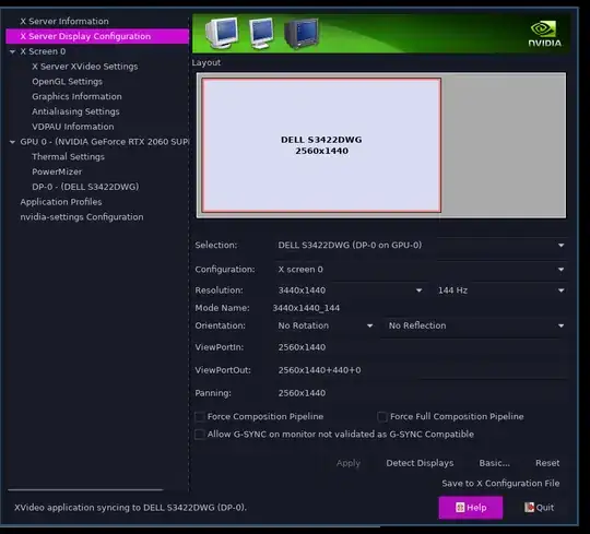

I got closer using the nvidia-settings application. It has an underscan mode. I used the following settings:
Nvidia-settings

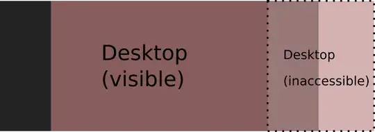

This is very close; I see a 2560x1440 area in the middle of the monitor, and there's no panning evident, but the X session still seems to be seeing a wider desktop, which is truncated on the right.
Result of nvidia-settings
Can I do something with Xrandr to fix this desktop size? If I try xrandr --fb 2560x1440, I get xrandr: specified screen 2560x1440 not large enough for output DP-0 (3440x1440+0+0).
