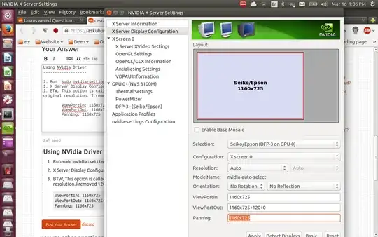

I put this here for who uses NVidia proprietary driver. So if it is not the case, please add to the question the driver you are using. (Such advanced options depends on the used driver)
  1. Run sudo nvidia-settings
  2. X Server Display Configuration tab → Set monitor from 'Selection:' → Advanced
  3. BTW, This option is called Under Scan. Here an example for my monitor with 1280x800 original resolution. I removed 120 from left and 75 from bottom to keep same ratio.
    ViewPortIn: 1160x725
    ViewPortOut: 1160x725+120+0
    Panning: 1160x725
  4. Apply
Note: You can save as the following screenshot to confirm it's size 1160x725
Margin can be seen here:
