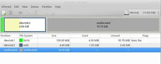

I have tried with GParted: it creates a partition with 4GB with no problem, however the whole .img of the SD card continues to be 16 GB with 12 GB of unallocated space.
GParted table
I have read the question and answer Cloning multiple partitions in Ubuntu, but I still cannot re-size the 16GB SD card into a 4GB one.
More info
~$ lsblk
sdc 8:32 1 14,9G 0 disk ├─sdc1 8:33 1 100M 0 part └─sdc2 8:34 1 4G 0 part

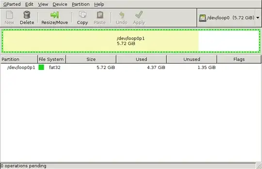

Let's load the new device using GParted:
sudo gparted /dev/loop0
When the GParted application opens, it should appear a window similar to the following:
screenshot
Now notice a few things:
  • There is one partition.
  • The partition allocates the entire disk/device/image.
  • The partition is filled partly.
We want to resize this partition so that is fits its content, but not more than that.

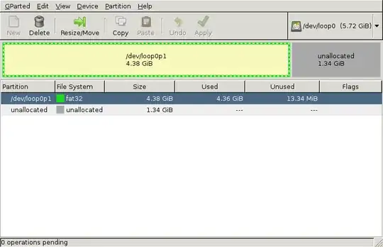

Select the partition and click Resize/Move. A window similar to the following will pop up:
screenshot of dialog
Drag the right bar to the left as much as possible.
Note that sometimes GParted will need a few MB extra to place some filesystem-related data. You can press the up-arrow at the New size-box a few times to do so. For example, I pressed it 10 times (=10MiB) for FAT32 to work. For NTFS you might not need to at all.
Finally press Resize/Move. You will return to the GParted window. This time it will look similar to the following:
unallocated space on right
Notice that there is a part of the disk unallocated. This part of the disk will not be used by the partition, so we can shave this part off of the image later. GParted is a tool for disks, so it doesn't shrink images, only partitions, we have to do the shrinking of the image ourselves.
Press Apply in GParted. It will now move files and finally shrink the partition, so it can take a minute or two, but most of the time it finishes quickly. Afterwards close GParted.

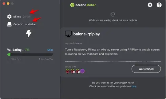

I can then use balenaEtcher or ApplePi-Baker to burn the ZIP file to the "smaller" SD card.

The partitions need to be at the start of the disk (like in the picture you provided).
