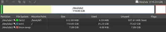

  2. A home partition
Seen below is the original installation on a 128GB SSD, which I successfully cloned to a larger 250GB. This as a backup that I would later try to resize and shrink down.
ORIGINAL INSTALLATION

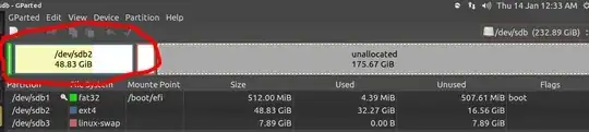

Below is a photo of a working clone of the operating system, which is now about 41 gigs in size total after being resized with Gparted.
/dev/sdb2 circled

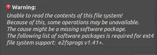

So perhaps my image was OK, but it didn't properly read /dev/sdb2/ so I checked it with Gparted again and saw this following here:
Warning! Unable to read the contents of this file system. The cause might be a missing software package. The following list of software packages is required for ext4 file system support: e2fsprogsv 1.41+.
I checked with Synaptic Package Manager to see, and I already have e2fsprogs v1.42.9-3 installed. So I did some reading and tried the following solutions that have worked for other people:

this seemed to work temporarily, as after another reboot or two, the problem still persists. I am assuming now that during the device to image process in Clonezilla that my /dev/sd2/ was not read properly, as I can not even access this partition in Nautilus or Gparted. I am thinking that is may have been caused by the re-sizing of the drive, but can not be sure, as it will still allow me to boot to this installation.
I think I can actually clone these two partitions to image, and then restore them but I need to address this problem of:
The following list of software packages is required for ext4 file system support: e2fsprogs v1.41+.
Could this have come from re-sizing the partition? If so, how come I am able to boot to this installation if it can't be read?
