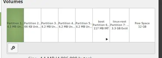

Truncate 2 partitions image
sudo losetup --partscan /dev/loop13 disk_image.img
sudo e2fsck -f /dev/loop13p1
sudo e2fsck -f /dev/loop13p2
sudo resize2fs /dev/loop13p1 -M
sudo resize2fs /dev/loop13p2 -M
### RUN THE "DISC" software and resize partition using the gui
fdisk -l disk_image.img
sudo losetup --detach /dev/loop13
truncate -s $(INSERT THE (END*BLOCKSIZE) OF PARTITION2 HERE) disk_image.img
mkdir /tmp/disk_image
sudo mount /dev/loop13p1 /tmp/disk_image
sudo fstrim -v /tmp/disk_image
sudo umount /tmp/disk_image
