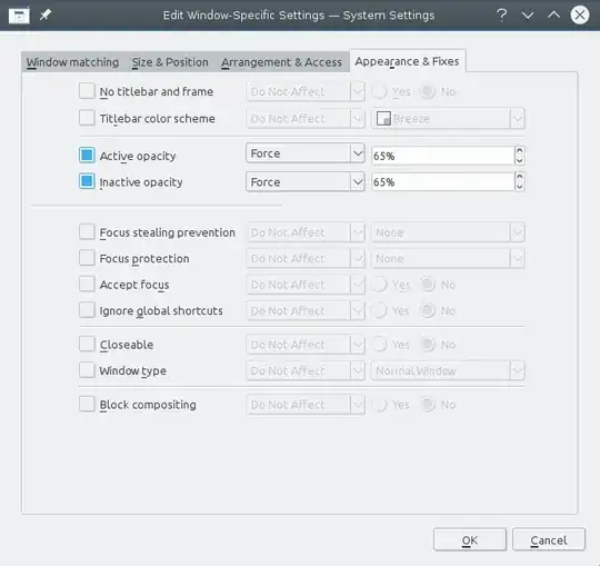

Go to System Settings > Window Management | Window Rules. Press New... button. Give some description to the new rule, Dock Transparency, for example. Then select only Dock (panel) in "Window types:" field. Switch to the last tab and set these options:
Pic1
Press OK then Apply new settings. Change 65% to whatever you see fit.
N.B. This method makes other objects on the panel (i.e buttons and text) more transparent, so don't use too low values in that case.

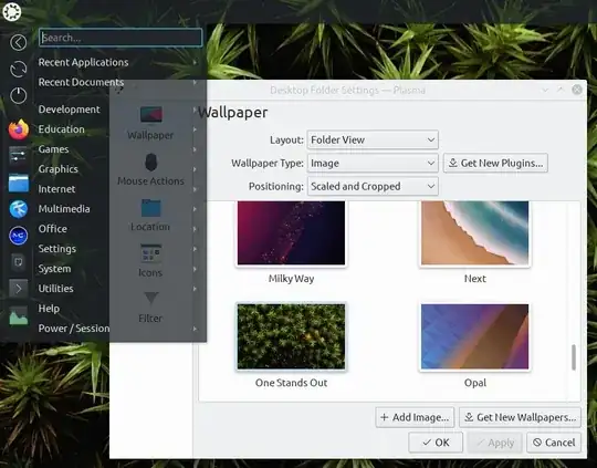

Find the [ContrastEffect] section and increase contrast parameter in it. I find contrast=2.0 most appropriate (you can try another values if you like). Blur effect will be applied automatically. Re-login to make it work. You should see something like this:
Pic2

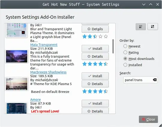

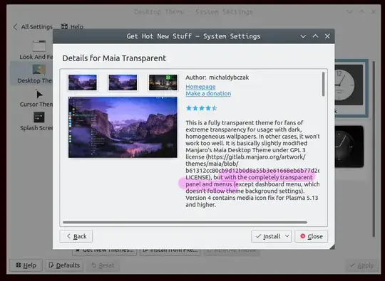

If you want to try other themes offering transparency, open System Settings > Appearance > Workspace Theme > Desktop Theme and click on Get New Themes. In the window that opens, enter something like panel transp in the search box and choose the sort order you want.
Get new themes from KDE Store
I came across one:
Theme offering transparency
Of course, you'll need to find a theme that's developed for your version of KDE Plasma.

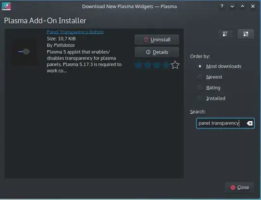

But there is Panel Transparency Button, which provides exactly what is expected. (On KDE store the link seems to be dead at the time I am editing this answer, but the Github link is this. In case the widgets become unavailable write me a comment hereunder, I might post a link to the packages I have.) — See EDIT at the end.
The widget can be installed and added through the "add widgets" interface

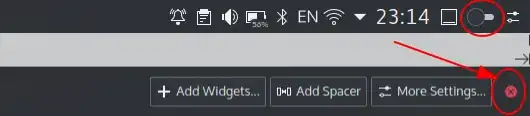

After that, in 20.04 edit panel to make the button visible, but close the editing to use the button.
The button is hidden after "finishing customizing layout"
