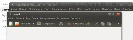

It can be done pretty easily in Unity/Compiz by gsettings altering metacity-theme-active-opacity and metacity-theme-inactive-opacity keys of the org.compiz.gwd schema. This will produce the titlebar effect looking like this:
Unity pic

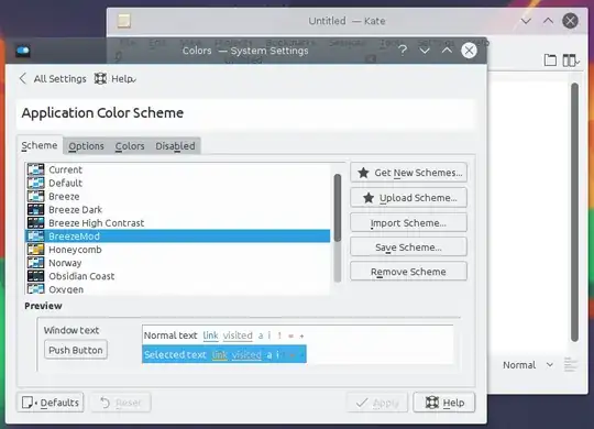

Now this theme should be activated. Open System Settings > Color, press Import Scheme... and open BreezeMod file, then press Apply. Here's the result:
