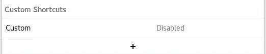

In the GNOME Settings GUI it shows up as "Disabled":
GNOME Settings Custom Keybindings, where the custom keybinding is shown as disabled

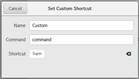

But when clicking on it, it shows that it is bound to the Super key: GNOME Settings that shows that the keybinding is set to the Super key
