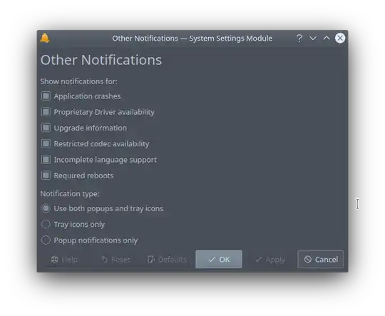

You can access this GUI via a terminal by running
kcmshell5 kcm_notificationhelper
The image below is from Kubuntu 19.04 with Plasma 5.16.2 (which is provided by the kubuntu-backports ppa.)
GUI for managing certain notifications
Alternatively, open System Settings and search for "Other notifications" to get the same GUI.
