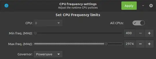

The easiest way I found recently was to install the utility cpupower-gui
No bash scripting or config files to mess with, just run:
sudo apt install cpupower-gui
Then launch it as root with:
sudo cpupower-gui
It has a very simple interface. Make sure you check the box for All Cpus and click "Apply" or it won't do that much!
