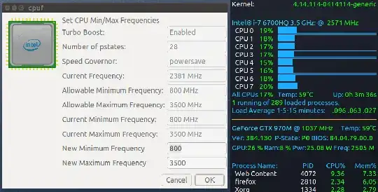

I wrote cpuf GUI to set minimum and maximum frequencies at will. You can use it just before your Math app to set all frequencies to max. After running your Math app you can reset frequencies normal for long battery life and less heat.
cpuf - Simple Bash GUI to set CPU Min/Max Frequency
Demonstration
In this demo cpuf window is on left and conky system information is on right side. This is how the demo progresses:
  • Demo starts whilst youtube video is already running
  • Default CPU min/max frequencies are 800 / 3500
  • Override CPU min/max to 800 / 800 and CPU usage jumps to 20%
  • Override CPU min/max to 3500 / 3500 and CPU usage drops to 10%
  • Demo loops back and starts again
With three monitors cpuf can appear 10 feet away, so use parameter 1 --geometry option to put it close to conky:
sudo cpuf --geometry="450x450+4720+80" /home/rick/Pictures/icons/cpu-intel-128.svg
  • Parameter 1 --geometry is Window Width x Height + Width Offset + Height Offset
  • Parameter 2 can be your own icon (in this case Intel CPU image) otherwise it defaults to computer icon
