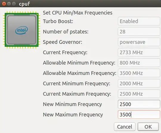

Edit May 13, 2019 - simple bash GUI script
I wrote this simple bash GUI script to change minimum and maximum frequencies:
