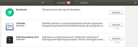

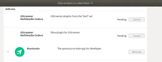

I attempted to install a GStreamer package using the Ubuntu Software Centre some time ago and the installation failed. Since then I have had 2 pending package installs listed in the Ubuntu Software Centre > Installed tab which I cannot get rid of.
Periodically when I open Ubuntu Software Centre I am greeted by an error: Unable to install "GStreamer Multimedia Codecs" as not supported - see below. I always have an alert in the tab names - i.e. Installed 2, and in order to see the 2 pending packages I have to click the tick box in the top title bar (to the right) - see screenshots below.

Before clicking on the tick
2 mysterious errors
After clicking on the tick
Once you click on the tickbox

In my case, the message went away after installing ubuntu-restricted-extras:
sudo apt install ubuntu-restricted-extras
