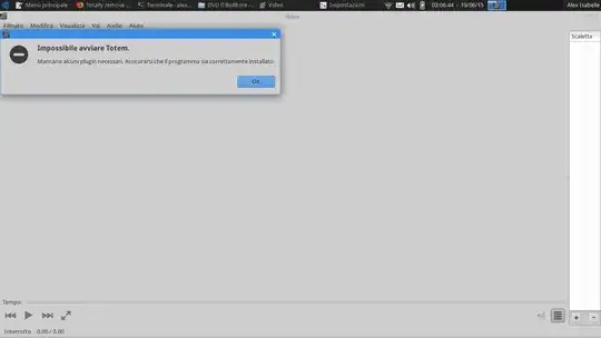

What's more, now Totem doesn't work, and if I try to start it from terminal I get this message in the GUI:
It's in italian, it reads: "Impossible to start Totem. Some necessary plugins are missing. Check that the program is correctly installed".
After I click "ok" it closes itself, and in the terminal I read this:
alex@Sargon:~$ totem
** (totem:3702): WARNING **: Element 'playbin' is missing, verify your installation
** (totem:3702): WARNING **: Element 'audioconvert' is missing, verify your installation
** (totem:3702): WARNING **: Element 'scaletempo' is missing, verify your installation
** (totem:3702): WARNING **: Element 'autoaudiosink' is missing, verify your installation
(totem:3702): Gtk-WARNING **: A floating object was finalized. This means that someone
called g_object_unref() on an object that had only a floating
reference; the initial floating reference is not owned by anyone
and must be removed with g_object_ref_sink().

On 14.04 totem requires libgstreamer1.0-0, not the 0.10 version. Moreover 14.04 ships both versions (See the release manifest) so in theory you didn't need to install a newer version to get 1.0.
First of all I would ensure that the system packages are installed properly, open a terminal and type the following command:
sudo apt-get install --reinstall gstreamer1.0-alsa gstreamer1.0-libav gstreamer1.0-plugins-bad gstreamer1.0-plugins-base gstreamer1.0-plugins-good gstreamer1.0-plugins-ugly gstreamer1.0-pulseaudio libgstreamer-plugins-bad1.0-0 libgstreamer-plugins-base1.0-0 libgstreamer-plugins-good1.0-0 libgstreamer1.0-0
This will reinstall a bunch of gstreamer 1.0 packages that should allow to use the base plugin elements (such as playbin and autoaudiosink).
But since you installed gstreamer from source, you may have to remove the libraries that you installed in /usr/local/lib.
If someone screws up with GStreamer and lose ubuntu desktop, can try:
sudo apt-get install --reinstall ubuntu-desktop
