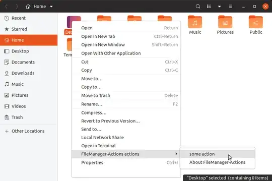

The corresponding menu item will be shown in the right mouse click menus:
Nautilus with fma
