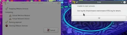

I have a question very similar to (15.04 VMWare Player "unable to start services" error) in that the modules cannot be compiled.
However, the top solution does not work for me. Error
Here is the terminal commands that I used:
