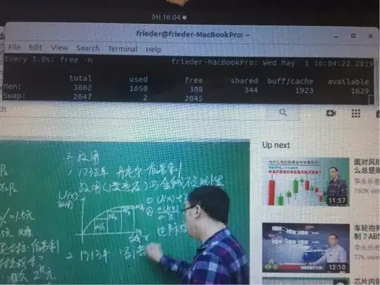

Switching to Intel and removing Nvidia caused the computer to not freeze for more than 3 days, but unfortunately it again froze two times today. I used @jackw11111 advice, and managed to take a picture of the memory usage through the Terminal when it froze the second time. enter image description here
What I find strange is that not all the RAM was used when it froze.

Perhaps try monitoring your real-time memory usage with the command : watch -n 5 free -m
(You could try right click Terminal window and select Always on Top so that you can see how much free memory you have when it crashes).
Also with the same command, have a look at how large the swap file is. This is slower (hard drive space) memory that is used to free up RAM, only necessary on systems with <3GB RAM, but if your swap memory is 0, and you are getting drops down into <100 MB (possible if you have lots of tabs in browser, IDE open, etc...) then you might need to look into creating a swap file.
