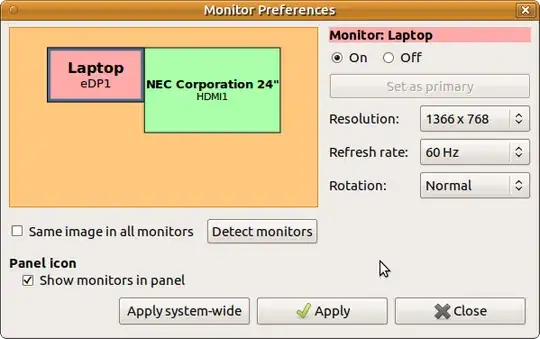

  • It is possible, that Ubuntu has detected two screens on your laptop (internal LVDS and external by HDMI), you can check it by changing the settings on monitors:
    1. Login to the MATE desktop from LightDM or other greeter.
    2. Open MATE terminal with Ctrl+Alt+T.
    3. If terminal is invisible - move it to the active screen by pressing Alt+F7 and moving mouse to the right or to the left to have terminal window on screen.
    4. From this terminal execute mate-display-properties and ensure, that current screen is set to Primary:
      Monitor Preferences
      switch other possible monitors to Off and click Apply.
    5. Check that MATE Panel is displayed on laptop screen.
