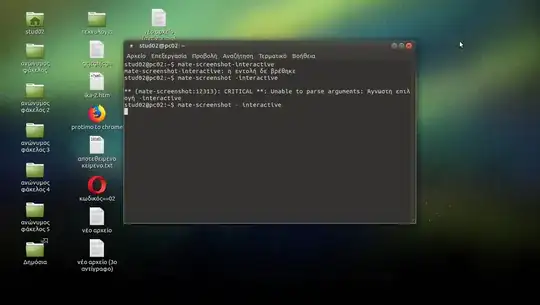

no bar
This is my desktop. No bar exists. (the version of my Ubuntu is 16.04.6 LTS)
