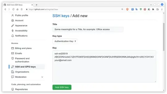

5. Go to your GitHub account and follow these steps:
  • From the drop-down menu in upper right corner select Settings.
  • Then from the menu at the left side select SSH and GPG keys.
  • Click on the New SSH Key button.
  • Type some meaningful for a Title and paste the content of ~/.ssh/github/id_ed25519.pub in the field Key.
  • Then click on the Add SSH Key button.
