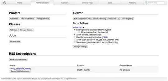

Now, you can use set up all printers via the server's desktop (if it has one) or the CUPS interface at http://<ServerIP>:631/. When asked for authentication on the web interface, use your root or admin user credentials.
CUPS web interface
