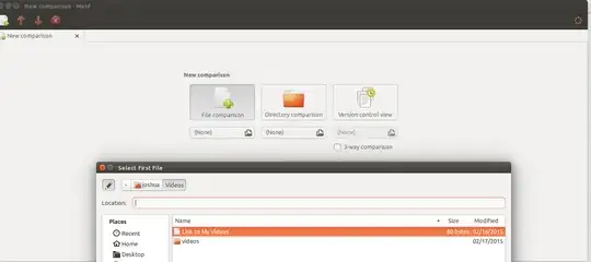

I can drag two files into the Meld GUI. I can also click File comparison (see screenshot), then choose one file, compare that to nothing, then choose the second file. This seems roundabout. I want to compare two files, preferably in a multiselect filepicker GUI.
Screenshot showing file picker
Even better would be to right-click one or two files in Nautilus to run Meld.
Is either of those possible?
