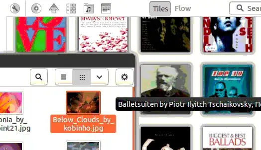

If you are using Rhythmbox v2.97 and later you can instead drag-and-drop pictures from Nautilus onto the album-art plugin and it will update your album-art - make sure you are playing your music track first when doing this.
pic
If you are using Rhythmbox v2.96 you cannot use this drag-and-drop technique. However, if you use my rhythmbox plugin coverart-browser, you can similarly drag-and-drop pictures onto your albums.
pic2
