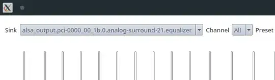

In the end, I've been able to manually tune the subwoofer by noticing that Pulseaudio's qpaeq, that I was already using in order to equalize the 'normal' speakers, does provide per-channel equalization.
qpaeq
I've set up a low-pass filter and now I've finally been able to reproduce only the low frequencies through the subwoofer. It's important to set the audio system as 2.1 in Pulseaudio's settings, since keeping the default stereo profile causes the 3rd channel, the one referring to the subwoofer, to be misssing in qpaeq.
