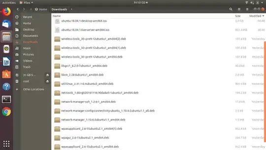

These are *.deb packages and *.iso files I have access to in server:
Screenshot showing downloaded iso and deb files

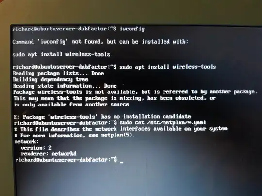

@chili555 I can't use iwconfig because I can't install wireless-tools without internet? I can't seem to install packages from my dual accessible drive shown in the picture above? I also get the following with sudo cat /etc/netplan/*.yaml:
photo of attempt to install wireless-tools

Let's amend your netplan file. From the terminal:
sudo nano /etc/netplan/01-netcfg.yaml
Amend the file to read:
network:
  version: 2
  renderer: networkd
  wifis:
    wlo1:
      dhcp4: true
      dhcp6: true
      access-points:
        "network_ssid_name":
          password: "**********"
Of course, substitue your network name and password. Note that both are enclosed in quotation marks ".
Netplan is quite strict about indentation and spacing; proofread carefully. Next, do:
sudo netplan generate
sudo netplan apply
Reboot and tell us if you connected:
ping -c3 www.ubuntu.com
If you get ping returns, you are all set.
Reference: https://netplan.io/examples
