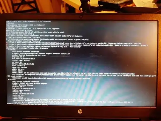

I also wanted to follow the instructions from here but this requires the command iwconfig which I have not currently installed. When I try to install it with sduo apt install wireless-tools (with ehternet cable plugged in) I get the error Temporary failre resolving 'testserv', although ping google.com works fine.
Finally, here is the output from sudo lshw -C network: enter image description here
Any advice what I am missing to get my wifi working?
