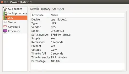

Ubuntu automatically keeps track of all batteries status:
Ubuntu Batteries Statuses
The same information displayed in the GUI screen above can also be accessed from your terminal / shell / bash script (they are all sort of the same thing in many ways).
To get the same information from CLI use:
$ upower -i $(upower -e | grep -i UPS)
  native-path:          /sys/devices/pci0000:00/0000:00:14.0/usb1/1-1/1-1.2/1-1.2:1.0/usbmisc/hiddev2
  vendor:               CPS
  model:                CP550HGa
  serial:               BFBB104#BI1.g
  power supply:         yes
  updated:              Fri 12 Jul 2019 06:35:56 PM MDT (12 seconds ago)
  has history:          yes
  has statistics:       yes
  ups
    present:             yes
    state:               fully-charged
    warning-level:       none
    time to empty:       25.5 minutes
    percentage:          100%
    icon-name:          'battery-full-charged-symbolic'
