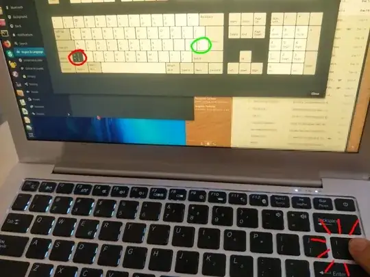

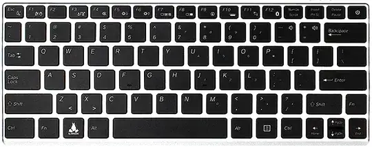

I have this exact keyboard, with US ANSI layout:
key1
I have just installed Ubuntu 18.04. In Region & Language, Language is defined as English (United States), Formats is United States (English), and the Input Sources is English (US).
All keys seem to map correctly except for the BACKSLASH KEY (\ and |). When I click on the backslash key, it maps to the </> (highlighted in red in the photo below) instead of the actual backslash key (highlighted in green).
See the photo I just took to see what happens... I have no way of typing \ and | (in fact I had to copy them from internet to ask this question), which is an absolute disaster.
key2
How can I solve this??

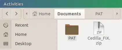

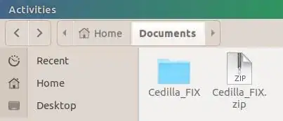

  1. extract the .zip file provided by supplier.
  1. bring out the sub-folder from Cedilla_FIX and rename it as PAT
make sure this PAT folder will contain below files.

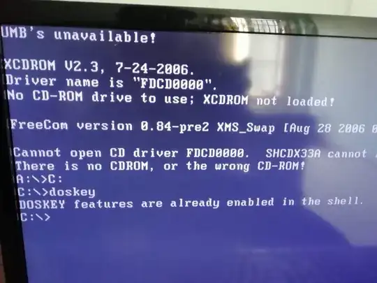

  1. insert the empty USB that we are going to make bootable.
  2. format the USB to FAT32 type.

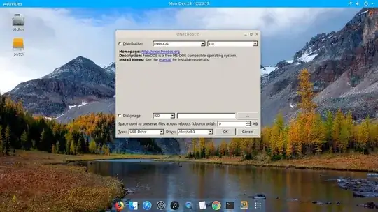

  3. open unetbootin sudo unetbootin
  4. select FreeDOS beside the text Distribution and proceed with OK.

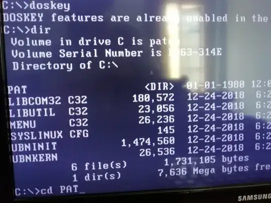

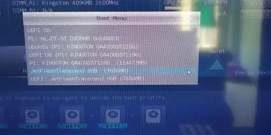

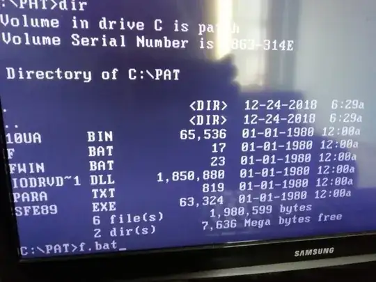

  1. now the USB became bootable, we need to paste the PAT folder in it.

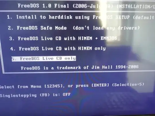

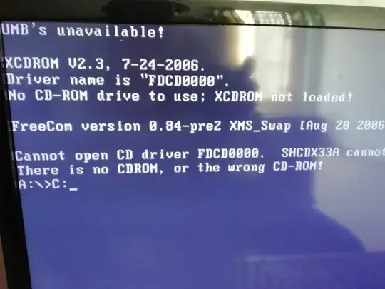

  1. now reboot the system and get into boot menu.
